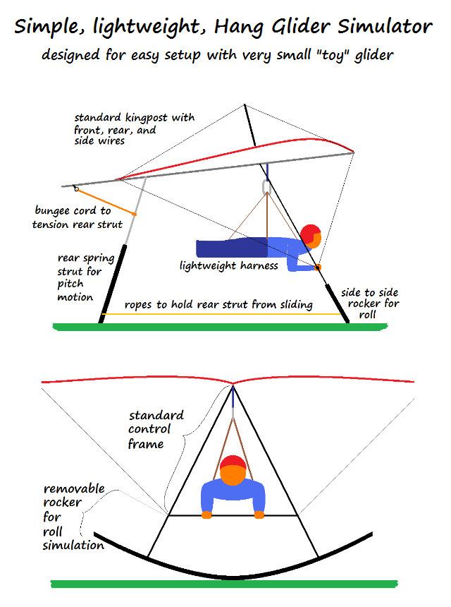

Looking forward to setting it up on blocks so they can feel what it is like to control a glider.
Here's the simulator that I posted to the hanggliding.org wiki (before I was banned :roll: ):
The rear support is optional because you can just hold the keel to give them fore and aft motion (be sure to have spotters for safety!). But the "roll rocker" is what's really needed to give them a sense of what it's like to steer the glider. I haven't done that with my glider yet, but it's on my list. I think if you could figure out some way to build a "cradle" for your base tube it would really enhance the experience.

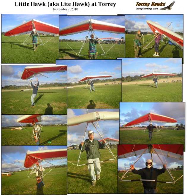

Little Hawk / Lite Hawk in the hands of pilots and friends at Torrey:
File comment: Little Hawk / Lite Hawk at Torrey November 7, 2010
The glider is coming along great, and it "flys" pretty well. John and I (mostly John) finished up all the top wires along with the lower front and rear wires. We've still got to do the side wires and then do a final positioning of the control bar. Thanks for all the help John!!
I also got a suggestion that "Little Hawk" might not sound adventurous enough, so I'm considering "Lite Hawk" as well. It saves one syllable, two letters, and is more in keeping with its heritage as a Moyes Xtra Lite - although it's also got some parts from a Falcon ... and possibly even a Predator!!
