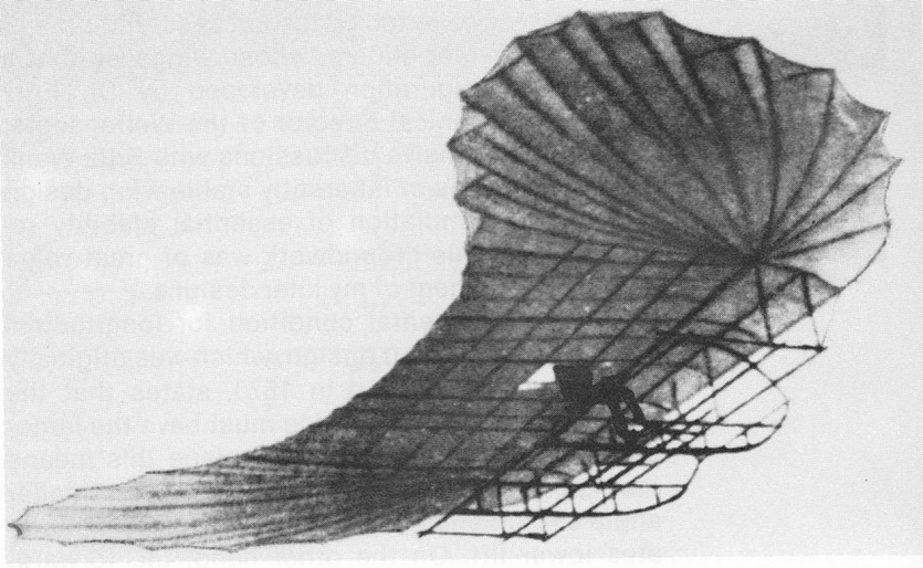

Re: When will one show at Dockweiler?
Postby JoeF » Fri Jan 29, 2016 7:50 pm
When will an Etrich-seed-wing-mod hang glider show at Dockweiler?
See: http://flyingmachines.ru/Site2/Crafts/Craft29003.htm
