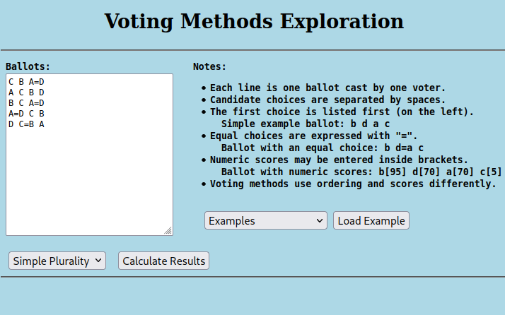

Introduction to JavaScript Voting Program (Version 021)
I've recently rewritten my 2010 voting program (originally written in Java) as a JavaScript program (see previous post for download). The interface is somewhat similar to the original, but it has been improved in a number of ways. Here's a screen shot of what it looks like when you first open it:
If you don't change anything and click on the "Calculate Results" button, you'll find that those votes select "A" as the winner. That result would be based on the "Simple Plurality" default voting method setting. But if you change the "Simple Plurality" setting to "Condorcet" and click "Calculate Results", you'll find that those same votes will select "C" as the winner. So what's up? How can the same ballots produce different results? That's what this post is all about. Please read on ...

Ballot Area Description
The ballot area is the large text entry box in the upper left corner of the page. The "Notes" section (to the right of the ballot area) describes the expected format of the ballots in the ballot area:
  • Each line is one ballot cast by one voter.
  • Candidate choices are separated by spaces.
  • The first choice is listed first (on the left).
          Simple example ballot: b d a c
  • Equal choices are expressed with "=".
          Ballot with an equal choice: b d=a c
  • Numeric scores may be entered inside brackets.
          Ballot with numeric scores: b[95] d[70] a[70] c[5]
  • Voting methods use ordering and scores differently.
You can type ballots in directly. You can copy and paste ballots from other sources. You can select and load from among the predefined examples.

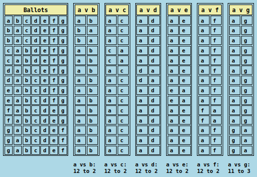

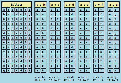

Hidden Consensus Example
The "Hidden Consensus" example demonstrates a strong consensus candidate ("a") running against a number of "factional" candidates ("b", "c", "d", "e", "f", and "g"). Simple Plurality selects a winner of "g" because there are 3 voters (out of 14) who listed candidate "g" as their first choice. So plurality selects a winner of "g" even though 11 out of 14 voters expressed a preference for "a" over "g". In fact, "g" was the last choice for 11 out of 14 voters. Similarly, the Instant Runoff method eliminates the consensus candidate "a" in the first round because the consensus candidate is not strongly endorsed by any of the factions. So Instant Runoff selects a winner of "b" even though 12 of the 14 voters expressed a preference for "a" over "b". Here are the ballots:
a b c d e f g
b a c d e f g
b a c d e f g
c a b d e f g
c a b d e f g
d a b c e f g
d a b c e f g
e a b c d f g
e a b c d f g
f a b c d e g
f a b c d e g
g a b c d e f
g a b c d e f
g a b c d e f
Here are the results from the Condorcet method:
The leftmost table (above) shows the original ballots. The remaining tables ("a v b", "a v c" ... "a v g") show the one-on-one comparisons of candidate "a" with each of the other candidates ("b", "c", "d", "e", "f", "g"). The text below each table shows the vote count by which candidate "a" defeats each of the other candidates:
a vs b:12 to 2
a vs c:12 to 2
a vs d:12 to 2
a vs e:12 to 2
a vs f:12 to 2
a vs g:11 to 3

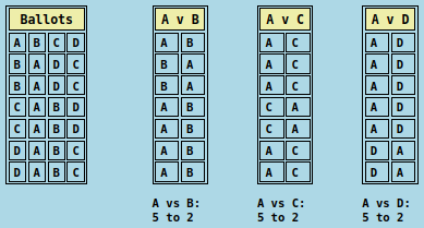

Java Strong 2nd 2 Example
The "Java Strong 2nd 2" example is another case where the Condorcet winner ("A") would easily defeat every other candidate (by 5 votes to 2 votes each) even though the Simple Plurality and Range methods pick other candidates.Here are the ballots:
A[9] B[4] C[3] D[2]
B[9] A[4] D[3] C[2]
B[9] A[4] D[3] C[2]
C[9] A[4] B[3] D[2]
C[9] A[4] B[3] D[2]
D[9] A[4] B[3] C[2]
D[9] A[4] B[3] C[2]
Here are the results from each of the 4 voting methods:
MethodResulting Winner(s)
Simple Pluralitytie between B, C, and D
RangeB
Instant RunoffB
CondorcetA
Note that the Condorcet method is the ONLY one to pick candidate "A" as the winner. Here are the results of running each of the other candidates against the Condorcet winner ("A") in one-on-one elections:

Postby Bob Kuczewski » Sun Oct 23, 2022 3:14 am
The Javascript Voting program is now available online here:
      https://ushawks.org/voting/index.html

Now, it's a fair question to ask: "Why should A be the winner?".
The answer is actually surprisingly easy. Candidate "A" can be proven to be preferred by the voters over EVERY OTHER CANDIDATE. Let's start by seeing how "A" would stack up against the closest competitor "B". Here are the ballots with both "A" and "B" highlighted in bold blue and bold red respectively:
A B C D   (ballot 1)
B A D C   (ballot 2)
B A D C   (ballot 3)
C A B D   (ballot 4)
C A B D   (ballot 5)
D A B C   (ballot 6)
D A B C   (ballot 7)
You can see from these highlighted ballots, that voter 1 (who cast ballot 1) preferred "A" over "B" because they ranked "A" higher than "B". So that's 1 for "A" and 0 for "B".
Voter 2, however, preferred "B" over "A" because they ranked "B" higher than "A". So that's 1 for "A" and 1 for "B".
Voter 3 also preferred "B" over "A", so now it's 1 for "A", and 2 for "B".
The remaining 4 voters (who cast ballots 4,5,6,7) all preferred "A" over "B". So that's a total of 5 for "A" and only 2 for "B". In other words, the voters have spoken - in their own ballots - that they would prefer "A" over "B" by a 5 to 2 vote. That's a landslide for "A". Yet ALL of the other methods excluded "A" and chose either "B" or a tie between "B" "C" and "D".
For completeness, here are the similar comparisons between "A" and "C" (5 to 2) followed by "A" and "D" (5 to 2):

You can run this example by copying either set of ballots above and pasting them into the "Ballots" area of the Voting program at:
However, to get the same results, it's better to use the second (middle) set with Range scores added. That's the example I'll be using here.
