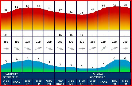

I talked to Hadley R. our local PG instructor and he thinks for the first time launching from the saddle area near the HG launch ramp should be done at 8 to 10 mph. I could bring a 12 by 24 foot tarp for sharp rocks and brush in the area.
Looking at launch code I see this:
Sat-Sun 31 & 01, 2015.JPG (41.4 KiB) Viewed 16251 times
My thinking is that 5 mph in the LZ (forecasted) is 15 to 20 in the saddle for Sat.
Sunday is a lower wind forecast and looks not so blown out for PG.
However way to the north end of the Little Floridas the rock face down in front stops. Also launching without a tarp is possible.
I never wanted to go there due to having to carry a HG that far. No problem with a PG it’s slightly down hill.
So I’m thinking if it’s above 8 to 10 mph in the saddle then drive as far as possible to where the road leaves the front, park, walk down to the north and launch to the west where the hill is rounded with no vertical rock face lower in front.
It is possible that any rotor that would affect a HG close to the hill would be under the PG when kited. But again this would not be a concern at the north end of the L. Floridas.
I’m good for either day or both.
SO---???
Re: Will be moving to NM soon!
Postby Wyatt » Fri Oct 30, 2015 7:13 pm
Yessssssssss! :D Thanks, Bill, for stepping up!
I'm seeing just 5-6 mph most of both Saturday and Sunday (Weather Underground). I think it should be alright for PG.
The saddle area would not be my launch of choice for tomorrow. It faces SW and if the forecast turns out to be right and there is some north component to the wind, we'd probably be catching some rotor at that launch. And it's a really tight launch for a PG. No reason for me to take that risk, when there's tons of easier launch to be found! The towers that are just one tower south of the northernmost ones have a perfect launch site for PG. I think that's the one you're talking about. A good launch spot is probably only 100 feet from the road. There are a few bushes at the edge of the cliff, but if you found the right spot it would be suitable for HG too. If you'd rather not hike that (of course, I'd help you carry your HG to launch), we could either park your truck at the saddle and I'll hike to the northern launch or if you don't mind I could just drive your truck to the northern launch. I'm assuming we're taking yours to the top and leaving mine at the bottom, as my truck doesn't have a HG rack.
