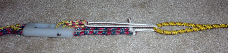

Need a number. From your photos my best guess is that the weak link is 5/64 inch / 205 pound Dacron leechline. That's gonna blow at about two hundred pounds - which would be pathetic - and does seem consistent with what you reported feeling.
Zack's crowd is using a loop of 205 Lark's Headed onto the tow ring loop of a three string release. It thus becomes an extension of the tow ring loop so you just ignore it and connect your three string normally. I'll attach his photo.
Zack claims it blows around six hundred pounds and - although I haven't tested it myself - that sounds about right. And that's a pretty good one-size-fits-all number.
I would advise that you connect your remaining release directly to the bridle and duplicate Zack's configuration.

I thought sure the loop of smallest diameter line would have been the "weak link".
Of course you're stepping down the tension with each loop so - not unless it's deliberately designed that way which, in my opinion, would be an idea second in crappiness only to your current configuration.
Start off with 400 pounds towline tension, the tow ring loop transmits 200 to the middle loop which transmits 100 to the trigger loop which transmits 50 of side loading to the pin. In the real world however - due to the stiffness of the material and friction - the numbers drop A LOT FASTER than that and make the release dysfunctional at low tensions. That's usually no BFD but since a barrel release has excellent performance over a huge range - when it's on the end of a bridle, from under four pounds to over seven hundred of towline tension no sweat - I don't see any point to using three-strings. (Plus there's no significant abrasion/wear involved in barrel release actuation.)
...the only one that protected me with a weak link break.
It didn't protect YOU - see above. And if it left you with the impression that it did, it actually accomplished the precise opposite.

P.S. I'm not seeing a way to get the photo up - may be a problem with my antique browser. But Bob can probably stick it in later if I send it to him. And anyway, the topic IS "missing release".
Admin Note: Here's the "missing release" that Tad sent to me by email:
- three_string_weak_link.JPG (70.44 KiB) Viewed 21384 times
