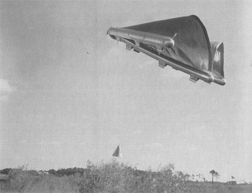

Francis and Gertrude Rogallo (right), inventors of the V-shaped flexible "parawing." In December 1961, Langley flight-tested a 5O-foot parawing's ability to bring down safely a model of a manned space capsule from a few thousand feet above Plum Tree Island (below), an old army bombing range near Langley Field.

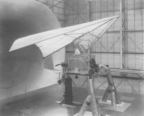

An early version of the single-seat Paraglider Research Vehicle ("Parasev") is test "flown" in Langley's Full-Scale Tunnel in January 1962. L-62-631.
An early version of the single-seat Paraglider Research Vehicle ("Parasev")[sic, Paresev for Pa..., res...v ] is test "flown" in Langley's Full-Scale Tunnel in January 1962. L-62-631.

As this research on the basic technology of the parawing gained momentum at Langley, NASA's STG, still at Langley at this time, grew interested in the possible application of the foldable, deployable, inflatable-frame paraglider to its Gemini EOR program. Specifically, the STG believed it might be used as part of Mercury Mark II, the follow-on to Project Mercury, which ultimately (in January 1962) became Project Gemini. The STG felt that such a wing could be deployed either before or after reentry to provide controlled glide and horizontal landing. Even on a lifting reentry body - NASA was giving "lifting body" technology considerable attention in relation to space station studies during this period (see the epilogue) -tests at Langley and other NASA facilities were showing that a parawing could improve the post-entry flight or landing characteristics.46
In early July 1961, a few weeks before the second manned Mercury flight by Gus Grissom, Gilruth's organization initiated three well-funded design study contracts on the paraglider concept with Ryan, North American, and Goodyear. Of these three companies, North American would eventually produce the most acceptable plan -a study to explore the parawing as an earth-landing system for Project Apollo.47 A few weeks later, the STG began requesting that studies of the Rogallo-type paraglider be conducted at NASA centers. At Langley this led, on 31 August, to a research authorization for "Free-Flight and Wind-Tunnel Tests of Guided Parachutes as Recovery Devices for the Apollo Type Reentry Vehicle." By late fall, all of this work came together as a formalized NASA paraglider development program, with Langley and Ames responsible for the wind-tunnel tests and the Flight Research Center for scheduling manned flight tests. Starting in mid-1963, 12 manned flight tests were actually made at Edwards with a so called Parasev.48
If the United States had not been in a hurry to go to the moon, the Rogallo paraglider might have been used as the capsule recovery system for Gemini and Apollo; of course, if the country had not been in such a hurry, it would not have gone to the moon at all in the 1960s -and perhaps would not have gone there ever. As it turned out, the paraglider became "hopelessly snarled in a financial, technical, and managerial morass."49 Richard Hallion recollects the specific problems encountered during the flight tests at Edwards:
