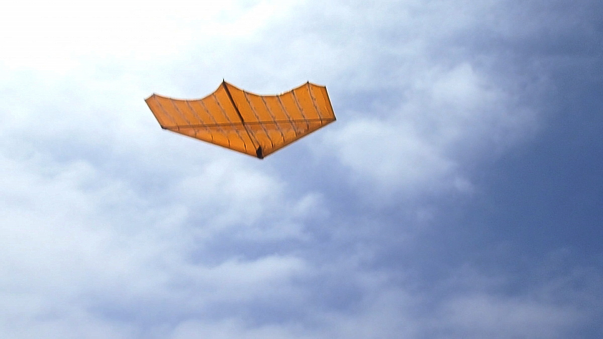

On august 17 with the covering firmly attached to the battens I got the model trimmed for stable gliding flight.
In the photo shown here I launched it from the top of Windsports training slope at Dockweiler. It climbed in the lift immediately to well above my head and then turned along the slope and climbed some more. It flew some distance soaring the slope all by itself (I had no controls) until it finally turned down wind and landed behind the slope.
Directional stability and pitch stability both looked good compensating for mild turbulence.
Encouraged enough by todays flight tests of the 1/5 scale model to start now on the full scale glider. First step will be to design the folding for transport capability of the airframe.
Basic Trainer model soaring the Dockweiler bluff 8/17/2018
Soaring the bluff.jpg (148.93 KiB) Viewed 4185 times

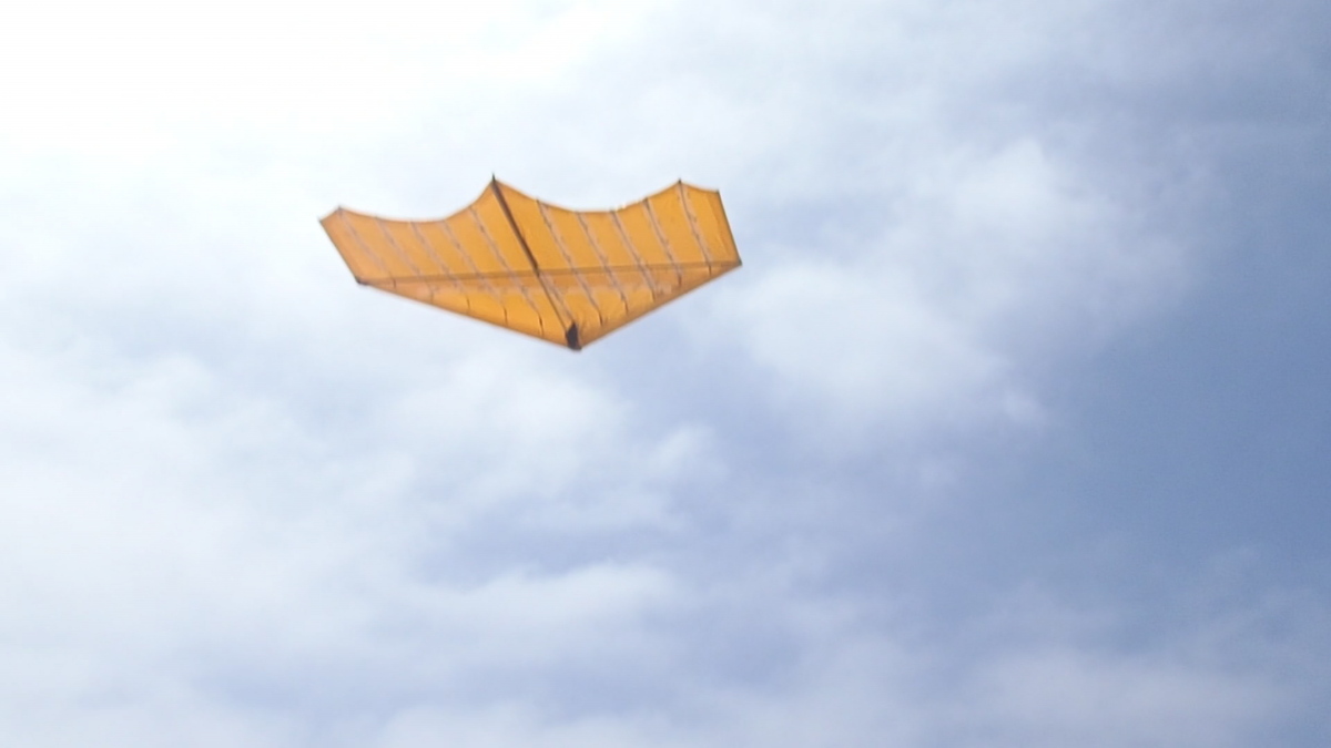

The model, without any external control, flew in stable flight above the low bluff at Dockweiler beach CA. The wind that day was a little gusty, especially for a beach site. Pitch recovery was good with the CG at 30.5% of MAC (mean aerodynamic chord). Directional stability was good and the model climbed in slope lift and one time it even soared the low bluff for a distance of several hundred feet on its own. When the model would turn off the wind it didn’t have any tendency to tighten the turn but made fairly flat stable turns. Because of the encouraging test results on the scale model, I’ve decided to go ahead with the full scale glider construction.

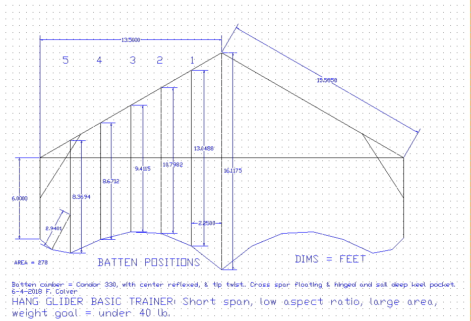

The design is a low aspect ratio, short span, high lift (high camber), large area glider. There is tip twist for pitch
stability reflexing and to stall the tips last and a "swallow tail" center that is also reflexed. It should be slow flying, with soft stall, stable but very responsive to weight shift control of pitch and roll. Some people have expressed concern about tip weight slowing roll response, because of the 6 feet long truncated tips. I point out that the 13.5 feet moment is shorter than other gliders of similar area, which will help. The complete glider weight goal is to be under 40 lbs.
The final design comes out at 27 feet span and approximately 280 sq ft. The weight will have to wait to be seen. I’ll use the lighter sail cloth also used on the Condor 330 and tubing sizes will be less than what would be used on a general purpose glider. The airfoil is the Condor 330 airfoil, and I will be using some of the actual 330 curved battens.
One area this glider might find its use beyond basic training is in soaring low beach front dunes “dune grooming”. Its short span, large area could make for good close in ridge soaring, keeping more of the glider in the better lift zone and the turns would be tighter.
All of my drawings are in AutoCAD, so I can’t attach them but I have attached a jpeg image of one drawing. I’ve also attached a photo of the model glider rising in slope lift above a hand launch.
I’m also looking for a wrecked salvage glider, preferably a WW Falcon or Alpha that I could cannibalize for fittings. Since I will not be selling this prototype glider I don’t need new fittings. I’ll be using all new tubing so I don’t care what condition the tubes are in or the sail. Please let me know if you know of one that’s available.
Basic Trainer, sail & battens design.jpg (324.29 KiB) Viewed 4184 times
1/5 scale model rising in slope lift.
Soaring the bluff.jpg (248.34 KiB) Viewed 4184 times
