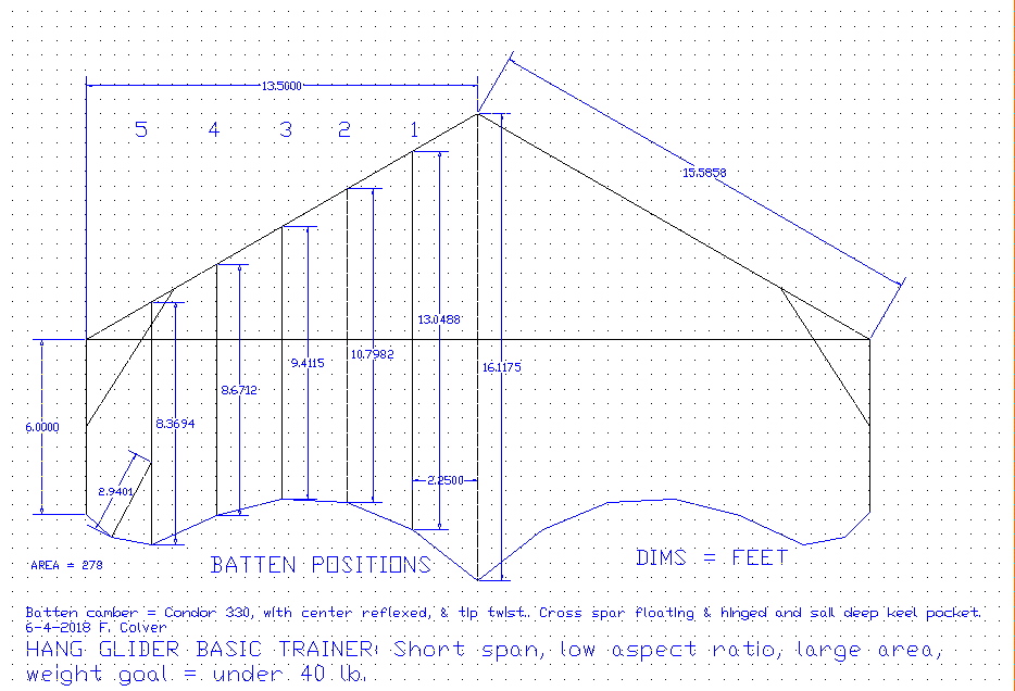

So, last night I looked it up on the web to see what size it comes in. It's a roll that is 9 feet wide by 150 feet long (1350 sq ft). The material weight is 1.8 oz per sq yd so on my glider this adds up to a total of about 3.4 lbs of sail. Very much in the ball park of a light dacron sail.
I am now seriously considering making the sail for the first go around on the Puffin out of Tyvek. At 9 ft wide it will only require one short span direction seam near the center and the center joining seam. Tyvek tape will do that job.

- Basic Trainer, sail & battens design.jpg (324.29 KiB) Viewed 13558 times
