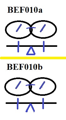

The abstract drawing for the BEF010ab includes stylized skyview and a front view. Recall that the BEF symbols allow angle and length variation in real material instantiation; line rigging is not placed in BEF symbols. And a plethora of options to "dress" a BEF remain to have multiple experimental hang gliders. The target is to dress a BEF and have the frame parts so that a handy tiny pack occurs where maximum length is 5 ft or less.
BEF010ab specializes in stabilizing hoops via stay lines to a beam askew from the hoop "plane", perhaps perpendicular to the hoop "plane" but not necessarily perpendicular. The"plane" is in quotation marks because it is possible to rig and stay a hoop without resulting in a geometric plane. The interior of the hoop would be filled with various options, not necessarily filling all the interior space. And the filling of the hoop interior space could be with single sail or double sail. Dressing a BEF could include winglets, High Hats, Safe-Splats, control devices, stuffers, or more. Finally, the BEF010ab symbol show rings that look circular; instantiations of BEF010ab may distort the hoop to non-circular forms.
The "b" does not have a base frame beam for TCF; rather the "base" would be a cord or cable, perhaps with a thickening as needed; or BEF010b might have control queenpost hard framed to the wing frame.

Notice that BEF010ab is quite different from BEF007.

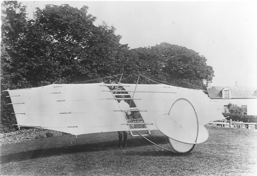

The Beetle is interesting; Percy Pilcher had more than one version of hang glider. The Beetle has distinct beams for empennage, and thus might not be an instantiation of BEF010; we seek a BEF symbol for such as the Beetle.
- This not using BEF010
- Pilcher_Beetle.jpeg (127.68 KiB) Viewed 1393 times
