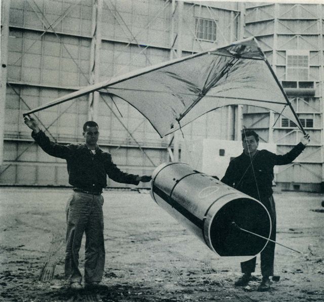

When I worked in NASA’s special projects group at Langley Field, Virginia, we actually tested this concept with a six foot long 30” diameter fiberglass semi-scale model of the Saturn booster rocket that carried so many capsules into space. Normally, at the end of a spacecraft launch the empty booster rocket would separate and fall toward earth hanging from parachutes until it splashed into ocean.
- John Worth, right, and simulated Saturn booster rocket with Rogallo wing. Dropped from a helicopter with the wing folded like an umbrella, wing unfolded and was steered to ground by RC.
- RW1.jpg (84.47 KiB) Viewed 3141 times
In our experimental concept, with the parawing deployed instead of parachutes, the booster would be steered from the ground by radio control and landed at an airport. Assuming a safe landing, the booster could then be reworked for future launches, with much less trouble, time, and cost that was involved in salvaging a booster that had fallen into the ocean.

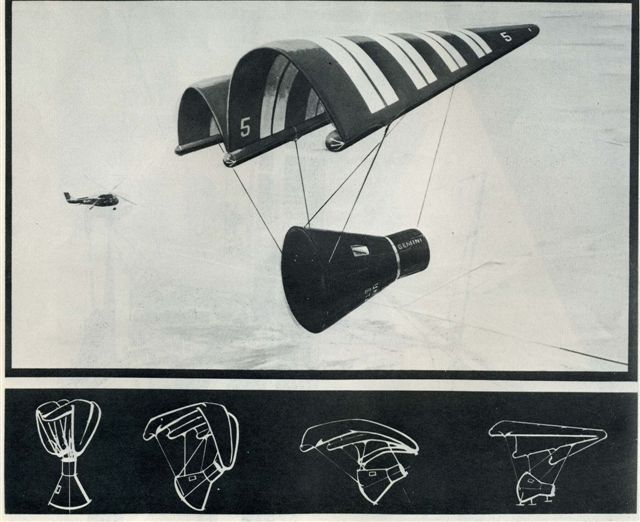

The concept worked well in model form and I still have movies that show the model being dropped from a helicopter and then steered successfully down to the ground. We also did something similar with a models of the Mercury and Apollo spacecraft, to show how astronauts could fly their own spacecraft while it was hanging from a parawing, and land on a runway instead of being dunked in the ocean as was the case when parachutes were used.
- Concept of Mercury capsule with inflatable tubes on aluminized fabric Rogallo wing, for fold-up stowage like that of a parachute. Drawings show sequence of deployment.
Note: a pressure canister was activated upon deployment to inflate the tubes which would become rigid enough to support the wing shape for flying.
- RW2.jpg (58.42 KiB) Viewed 3141 times

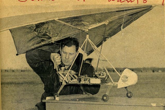

Meanwhile, Rogallo was interested in developing a powered version of the glider, to provide takeoff as well as landing capability. In our NASA workshop, therefore, we took a relatively small powered military target drone and replaced its conventional wing with a parawing. For the same weight the parawing provided several times the wing area, with which it could carry more payload than the conventional wing, and/or it could fly slower and get in and out of small fields.
- Here’s J. Worth working on the Fox 59 pusher powered model (with 8 channel reeds for RC) that was the basis for a full scale Ryan Flying Jeep prototype.
- RW3.jpg (76.29 KiB) Viewed 3141 times
We demonstrated a powered version which weighed 15 pounds, powered by a Fox 59 gas engine. It flew very well and attracted a lot of interest. It had very short takeoff and landing performance. The military envisioned it as a flying Jeep that could serve well in places like Viet Nam where regular aircraft runways were scarce. It was seen as a possible replacement for many situations where only a heavier and more expensive helicopter might be used. Also, enemy ground fire shooting holes in a fabric parawing was less likely to down the craft than holes in a rotor blade.

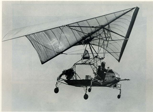

- The full scale Ryan Aircraft company’s Flying Jeep prototype, was intended to carry cargo on its flatbed platform behind the pilot.
- RW4.jpg (52.38 KiB) Viewed 3141 times
The Ryan company in California actually built a full scale piloted prototype of the flying Jeep and tested it extensively. But in one demonstration at Langley Field, Virginia, the Ryan test pilot pulled it off the ground too sharply, stalled it about a hundred feet off the ground, after which it crashed and badly injured him.
This put a damper on the project and with the Viet Nam war ended there was less urgency for the military to build a flying Jeep, so this NASA project, too, died. But the parawing survived, finally, as an ultralight hang glider which is still used by many who fly them for fun off of cliffs or steep hills.

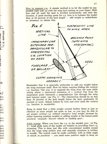

Incidentally, I ‘wrote the book’ on Rogallo type wings for models, with an 8 page article in the 1964-65 Model Aeronautic Year Book by Frank Zaic. The article is very detailed, with drawings, on the many aspects of flexible wing design, stability, and control. Although 40 years old (!), the book is still available, from the AMA through their store, for $15. The book is chock full of articles, model plans, and data; a best buy, as are all the Zaic Year Books.
- One of several illustrations in the Zaic Yearbook, showing proper c.g. location
- RW5.jpg (41.5 KiB) Viewed 3141 times
