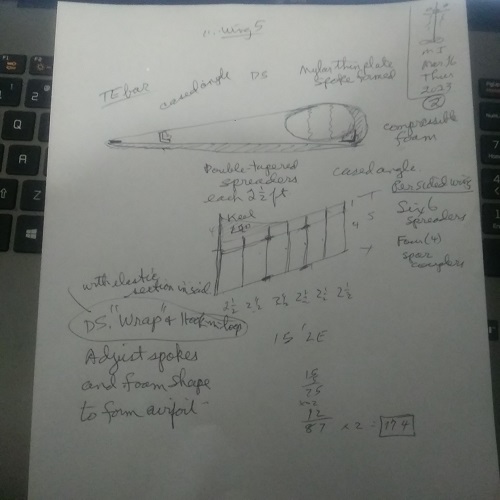

The immediate present note hereon regards a wing stuffer: a cylinder of Mylar heavy film or light plate or the like. As wing stuffer, the cylinder could give airfoil camber inside a DS HG wing. Now some notes about tiny packing such a deal:
Consider having the cylinder be segmented to 1 meter-or-so lengths, or about 3 feet; further have the segments be precisely telescopic to each other. Then, say have five segments telescopic to each other for the left wing and five segments telescopic to each other for the right wing. Let the collapsed five segments of the left wing act in tote as the case to hold other HG parts. End up then with a left-wing toted case and a right-wing toted case. Inside the left-wing case have the left-wing sail, left-wing spar couplers, and left-wing line sets. Then similarly for the right-wing parts. The two cylinders with parts could be vertically stacked to be one luggage hold. The beam segments of the HG could gather to a single pack of 5-ft long with low cross-section diameter. Thus, the tote would be of two packs. For off-bus carting, consider travois and ablating Teflon or polycarbonate plate or wheels or carry-and-backpack.

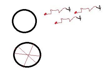

A note on the stuffer cylinder: consider string-spoking to stay shape while flying. String spoking might be accomplished by precise elastic string with poke-through rotatable tee tips to the elastic segments; one end of a string could be perma-flanged; the other end would have the rotatable tee-tip; have the flanged end be sail-interfacing; the sheath of the spoke could be inelastic. Or allowing temporary cylinder deformation, the string might not need to be elastic. Much to explore here!

8-) Note regarding segmented stuffer just mentioned. The string spokes may be judiciously lengthed and placed to stay a non-circular cross-section to help form desired airfoil potion.
Note: Consider applique at LE before wrapping DS sail: compressible foam. In tote segments of foam applique can squeeze down to low volume. Or the segments of compressible foam applique could be worn by the pilot during trek to th e flight sight. The foam coordinates with the spar, spoke-shaping stuffer, and sail to obtain desired airfoil shaping.
Note: Have beam spreaders every 30 inches. Have spar couplers at the 5-ft spar-segment ends. Have the wing spreaders overlap the spar beam (angles) and firmly bolt-joined or hard lashed or the like to give anti-twist to the spar segments. Have the 5-ft spreaders be joined by the spars at the 1-ft-from-TE and LE point; this will efficiently use the angle-leg height and reduce the unpinned beam length of the spreaders to 4-ft, with 1 ft aft of aft spar. SS or DS HG hereabouts.
Spreaders may be good candidates for "double tapering" design to obtain least mass for the HG; opportunity for one-part spreader or two-part spreaders; two-part spreader might give opportunity for wing chord to exceed 5-ft, if wanted. Thus 6+6=12 spreaders in addition to the keel that also spreads the two parallel spars. Spars: angles (with some casing set at assembly at site.). Eight (8) couplers for sparing: 4+4.
Note: Toted angle beams at assembly might receive some casing, full or partial. Casing could be sacrificial tape or hook-and-loop wrap or sock case, or the like; this can be explored to counter beam's angle's leg spreading during compression of spars from flight loads in a KP-QP rigging affair. Tolerate the draggy rigging.
Consider a TE bar set on the TE tips of the spreaders. Rectangular. Receives wrapping sail and firms the TE shape. Bar can be in tote segments of 5-ft or less. Bars will pack well.
Add central SS sail areas filling the keel aft end to 10-ft out on side wing, say 5-ft by 10 ft legged triangle, not right as sweep puts the triangle not right. But approximately 40 square feet is added to the HG. Rough area of HG: 190 sq. ft. 5,5,5,5,5,5 by chord 5; plus aft special area. Rough: 5x30+40=190 rough.
