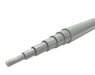

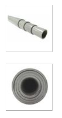

Exploring telescoping sections on one underway design:
Legend: A,B,C are tube segments that telescope: B fits inside A, C fits inside B. TCF: triangle control frame (initiated historically at least in the first decade of the 1900s, by at least W. Simon, as traced someplace in our forum).
:arrow: CBABC, CBABC for left and right spreader, spanwise. Notice that A has largest diameter and is in center of a compression affair; thus we get a double-tapered beam for left spreader, and a double-tapered beam for right spreader.
:arrow: BAB, A for aft keel and fore keel.
:arrow: C, C for two king posts (with aim for foundation of a High Hat).
:arrow: A, A for two queen posts (base of TCF will be line, not beam; line could be made comfortable by casing of compressible foam of some choice)
Take a tally: A: 6. B: 6. C: 6
That is: 18 tube segments. Or six sets of ABC.
With such tally, one might think of exploring window-washing extendable poles (extension poles) that have telescopic sections; the poles come in aluminum or fiberglass or carbon fiber. Section lengths in offered products may or may not fit HG desires. Specifications of such poles may or may not fit HG desires; shortening some segments of a product might be done, but perhaps a wasting choice. Product clamping may not be desired for HG; options like shear pinning come to mind. The tally has me considering looking for window-washing poles made of three sections: A, B, C. Six of such product might supply the HG design being mulled at the moment for this post. Pole products might not fit needs. And one might not want the handles and end tools that come with window-washing poles. Telescopic sticks, antennas? Option is to obtain the A, B, and C segments from other sources.
Packing notes on A, B, C. The 18 segments could pack as six unities where ABC telescope to make one unity. Let "O" represent ABC unity. Then packing could be represented in end view format:
OOO
OOO
or as
OOOOOO
A similar exploration may be done with four levels: ABCD.
That will be a later play.
or more?

Joe: How might we get a double-tapered beam by using telescoping tube segments?
AI: It is possible to create a double-tapered beam using telescoping tube segments by using a combination of different tube diameters and lengths. Here's one approach:
Start with two telescoping tubes of different diameters, such as a larger diameter tube and a smaller diameter tube that can fit inside the larger tube.
Cut both tubes to the desired length, making sure that the length of the smaller tube is shorter than the larger tube.
Insert the smaller tube inside the larger tube, leaving a gap at one end of the larger tube.
Joe: If a largest diameter tube is the center of the beam, then stepwise smaller diameter tubes on one end of the center tube, and similar stepwise reduction of diameters on the other end produces a doubly tapered beam
AI: That's a great point! Another way to create a double-tapered beam using telescoping tube segments is to start with a larger diameter tube as the center of the beam and then use progressively smaller diameter tubes on each end, creating a taper on both ends. The steps to create this type of beam are:
Choose a large diameter tube as the center of the beam.
Select a smaller diameter tube and insert it into one end of the large diameter tube, leaving a gap between the two tubes.
Cut the smaller diameter tube to the desired length, making sure that it is shorter than the large diameter tube.
Select an even smaller diameter tube and insert it into the end of the smaller diameter tube, leaving a gap between the two tubes.
Cut the even smaller diameter tube to the desired length, making sure that it is shorter than the previous tube.
Repeat this process with progressively smaller diameter tubes until the desired taper is achieved on both ends of the large diameter center tube.
This method allows for the creation of a doubly tapered beam that can be adjusted in length and taper as needed by simply adjusting the lengths of the telescoping tubes.
____
Joe: The secondary and tertiary tubes need not be shorter than the central tube.
AI: You're absolutely right! The length of the secondary and tertiary tubes used to create a double-tapered beam using telescoping tube segments does not necessarily need to be shorter than the central tube. The length of the tubes can be adjusted as needed to achieve the desired taper and length of the beam.
In fact, it may be desirable to use longer secondary and tertiary tubes in some cases to achieve a more gradual taper or to provide additional rigidity to the beam. The length of the tubes can be adjusted by cutting them to the desired length or by adjusting the overlap between the tubes when they are telescoped together.
Overall, the key factor in creating a double-tapered beam using telescoping tube segments is to select tubes of different diameters and adjust their lengths and overlaps as needed to achieve the desired taper and length of the beam.
______
I further nudged the AI language model:
Joe: What are some methods to prevent difficult sliding of segments of a telescopic pole?
AI: Preventing difficult sliding of segments of a telescopic pole is important to ensure the safe and efficient use of the pole. Here are some methods to prevent difficult sliding of segments:
Lubrication: Applying a lubricant, such as silicone spray or graphite powder, to the surface of the telescoping tubes can help to reduce friction and make it easier to slide the tubes in and out. It's important to use a lubricant that is compatible with the materials of the tubes and to avoid getting the lubricant on other surfaces that may be affected.
Cleaning: Dirt, dust, and debris can accumulate on the surface of the telescoping tubes, making it difficult to slide them in and out. Regularly cleaning the tubes with a mild detergent and water can help to remove any buildup and improve the sliding action.
Adjustment: In some cases, difficult sliding may be caused by misalignment or damage to the telescoping tubes. Adjusting the length of the tubes, realigning them, or replacing any damaged components can help to improve the sliding action.
Tension: The tension or pressure between the telescoping tubes can affect how easily they slide in and out. Adjusting the tension by tightening or loosening any locking mechanisms or adjusting the fit of the tubes can help to improve the sliding action.
Maintenance: Regular maintenance, such as inspecting for damage, cleaning, and lubrication, can help to prevent difficult sliding and prolong the lifespan of the telescopic pole. It's important to follow the manufacturer's instructions for maintenance and use to ensure safe and efficient operation.

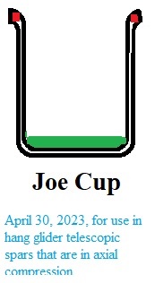

Introducing the "Joe Cup"
Gap filler, stop-insertion-limiting Joe Cup bushing ....l
The sketch's red represents a washer or ring that avoids wedging into the gap between two telescoping tubes.
The black line represents a sock or sleeve forming a double-wall that in use becomes highly tensed as the macro spar of telescoping tube segments goes into axial compression. The red ring is inside the double-walled sock and may be secured in place by some hand sewing pinching the ring into firm position.
The green is a loose ring or disk that is edged radiused on its lower end that faces the sock; the radius will soften the wearing that may occur at the interface of the loose disk and the lower part of the sock; the inner-going telescopic tube segment of a spar will have its insertion end meet the loose ring or disk and press very hard against that disk or ring as axial compression occurs in the macro spar.
The use of the sleeving Joe Cup is to remain so that a tiny looseness remains so that disassembly of tube segments remains possible without binding. The Joe Cup's sleeving might be Teflonized to aid in such assembly-disassembly effort. The Joe Cup limits the amount of insertion that occurs for the smaller spar-tube-segment.
When using the Joe Cup, note that there need be no holes in the side of the tube segments, no shear pinning, no tube clamps, etc. Joe Cups my have thin or thicker walling to accommodate the sizes of the tube segments being joined in the telescopic macro spar. Note that the sock-like construction of some Joe Cups allow for a very efficient toted packing for the Joe Cups, as they simply collapse into a flattish disk-like form; the Joe Cups may be packed in unused cavities of a pack or even "worm" as part ot the trekking pilot's clothes, as in pockets. If the ring is a bit flexible, then deformation may allow stuffing Joe Cups into the interior of toted tube segments.
Joe-Cup sock material may vary. Perhaps the sock that invaginates and closes may be made of Dyneema fabric. Other materials may be considered. One would want the flight loadings not to stretch the sock very much in order to keep HG specifications as desired. However, a bit of stretch might be useful in handling excessive tension caused from excessive compression in the spar when gusts or other overload events occur.
Note that a Joe Cup could also be like the following: a deep cupping stainless-steel lipped cup. The lip stands for the red in the sketch. The bottom of the stainless-steel cup represents the loose green disk. But such a stainless-steel cup may not tiny-pack as easily as other Joe-Cup designs.
Note: a Joe Cup need not be a full round cup but might be a ribbon-like depth limiting device where only say 30% of the circumference of the spar-tube end circle is faced. This might be explored but may not be as stree-spreading as full Joe Cup designs.
The final mass used in a Joe Cup may vary by choice of involved materials. One might explore any COTS lipped cups, even glass test tubes or beakers, etc. in search of a ready cup for use in a Joe-Cup situation for assembling tube segments to make a HG spar with intent of tiny-packing the spar. Taper or a hard cup is not wanted as the insertive spar segment won't be tapered, most likely. One might explore mods of COTS bottles, but watch out for shearing of the bottom of the device during loading. The upper lip of a Joe Cup prevents the cup from moving out of position; the lower lip inside or the lower full floor of the cup prevents the inside telescoping tube segment from entering further than wanted. Aluminum lipped cups of constant diameters may work, but tests should be run regarding fatigue and shearing.
Lips or flanges to cups are of interest; some shearing forces will occur in the HG use in axial compressed assembled spars.
Some COTS cup/beakers critiqued:
:arrow: Cole-Parmer® Essentials Griffin Low-Form Stainless Steel Beakers with Easy-Pour Rim is expensive; and the inclined lip would tend to wedge and break the spar's outside telescoping tube. So, such product would not be chosen by me. If given freely and if size satisfies one use, then the lip might be flattened to 90-degrees to stop the wedging. Further, such mod would be a rigid Joe Cup and have tiny-packing challenges.
:arrow: Lipped glass test tubes may not come in sizes wanted. But if exact fit seems nice, then such might work in some instances of smaller-diameter spars. But glass has its challenges!
:arrow: Avoiding a Joe Cup made from bonding pieces may not satisfy, as bonds may break. Labor may be high.
:arrow: Custom machined Joe Cups can get very expensive; the two lips and the precision diameters can run up prices to very high levels.
:arrow: Thermo-forming lips/flanges on a given thermoplastic pipe or tube might suffice in some HG telescopic-spar uses, but test should be run to prove or disprove integrity for safety. One would want to avoid wedging and shearing for assembled axially compression spar.
:arrow: Flanged aluminum tube bushing having not a bottom in-going flange would need to be modified to get a bottom in-going flange to form a Joe Cup; or a bonding or welding of a bottom for the the COTS flanged bushing. Depth of a COTS part may not be available. Wall thickness of a COTS part might be too thick.
:arrow: Inner and outer flanging of polycarbonate sheet or tube might be explored for Joe Cupping ends. Test for wedging and shearing unwanteds.
:arrow: Using spinning to form top out-going lips and bottom in-going lips on a given aluminum or steel thin-walled pipe might be a source of rigid Joe Cups; however, such rigid cups may not pack as well as non-rigid cups as described above.
:arrow: Le Minimum Joe Cup might be a loop of webbing grabbing two small segment of sticks, each placed in the turn of the flattened webbing. Hand stitch the central part of webbing. Let the webbing dip in the outside larger spar-tube segment keeping the two grabbed stick parts outside while the inner telescoping spar-tube segment fits into the outer tube pressing the webbing down into a Joe-Cupping position-limiting arrangement. This must be tested for wedging and shearing and wobble as gap-fill is not surround. |==================| sketches the device. End sticks and ==== webbing. Use a closed loop of webbing. Two of these could be used at one station of assemblage. +
:arrow: Start with flat material. Flange two opposite sides, one flange up, the other down. Roll the flanged flat material to form a split-sided sleeve. Call this a split-sided Joe Cup. The roll stays split for keen adjustment into the gap between two telescoping tube segments. Judicious sizing of the flat material will suffice to fit a given join of two telescopic spar segments. The cross section view of the flanged piece is near a Z with a long vertical part of the Z. The two flanges fulfill the needs of limiting the insertion of smaller telescopic tube in an axially-compressed macro HG spar made of several telescopic tube segments. This must be tested for wedge-slipping of upper flange and opening of lower flange during axial compression of the macro spar. If wedging or loss of flange protection occurs, then the part fails. Test for endurance and fatigue failure. Choice of materials will be key on this approach. DIY from flat allows customizing to needs of gap-fill and diameter matching.
:arrow: Post-Singularity (AI) design of a Joe Cup for tiny-packed hang gliders might be better than what has been covered so far. :idea: :idea: :idea: :idea:
Motivation resulting in Joe Cup comes from wanting to avoid clamps, holes in tube segments, shear-pins, shear-pin holes, cam-expanding devices, threads, and more.
