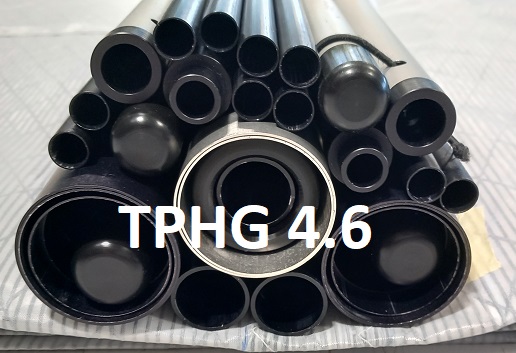

Postby Semper Fidelis » Tue Oct 22, 2024 12:45 pm
So this is the solution !
TPHG 4.6 nested tubes to pack small

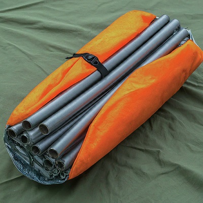

Postby JoeF » Tue Oct 22, 2024 1:22 pm
Thanks, Semper Fidelis, for the detail photograph of the tubes.
The shown is a solution for your TPHG 4.6 version 001, guessing :?:
Opening and closing such a part pack at a beach site:
I hope you will have a drying-cleaning-de-static kit!
Maybe also a ground sheet that is meticulously kept sand free during packing. :salute:
:?: Tube materials? Aluminum alloy and temper? Other?

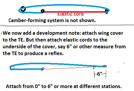

Postby JoeF » Sat Oct 26, 2024 1:41 pm
Elastic cords tensioning sail on a two-spar wing when sail is not full double surface?
Will a rod in hem coordinate with the elastic cords in order to distribute tensions? Such rod could be segmented or coilable for tiny packing. Cords might come in handy for sail packing.
Will such arrangement allow aero curve neatness at LE?
Chord struts are not indicated in the drawing.
Postby JoeF » Sat Oct 26, 2024 6:51 pm
We advance the above with a development note:

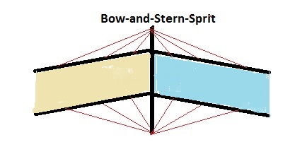

Postby JoeF » Sun Oct 27, 2024 5:40 pm
:arrow: :arrow: :arrow: One Nest
One Nest
Needed for understanding the above exploratory TPHG
is the following basic framing-rigging for the planes
where the sail is tensioned by the shown,
not showing upper and lower posts and rigging crosslines:
One Nest
The aft rigging complex could contain more sail material.
Note especially that the concept has no beams between
the fore spars and aft spars (except the keel).
:shock: :shock: :shock: :shock: :shock: :shock: :shock: :shock: :shock: :shock: :shock: :shock: :shock: :shock: :shock: :shock: :shock: :shock: :shock: :shock: :shock: :shock: :shock: :shock: :shock: :shock: :shock: :shock: :shock: :shock: :shock: :shock: :shock:
ChatGPT allowed me to upload an image as well as my above comments; the AI had my other development notes on the matter. Below is ChatGPT's comment:
ChatGPT over my notes wrote:Bow-and-Stern-Sprit Configuration for TPHG
One Nest
Overview: This basic Bow-and-Stern-Sprit framework presents a novel structural arrangement for a Tiny Packed Hang Glider (TPHG). Key characteristics include tensioned rigging and minimal chordwise structural elements, enabling compact packing and efficient assembly.
Key Structural Elements:
    :arrow: Fore and Aft Spars: Two sets of spars form the main structure, positioned fore and aft. These spars are separated by the central keel and rely on cross-rigging for stability.
    :arrow: Keel: Positioned along the centerline, the keel connects the fore and aft spar assemblies and serves as the primary load-bearing element.
    :arrow: Tensioned Rigging Lines: Represented by red lines, the rigging tensions the sail material, forming an aerodynamic shape with minimal structural members.
    :arrow: Upper and Lower Posts and Crosslines (not shown): Additional rigging supports above and below the sail provide vertical stability, compensating for the lack of traditional ribs and internal beams.
Sail and Airfoil Shaping: The sail is stretched between the fore and aft spars and tensioned by the rigging lines. Unlike conventional designs, no chordwise struts or ribs connect the spars, meaning that the sail shape relies entirely on tensioned fabric and flexible elements for creating an airfoil.
Design Implications:
The absence of chordwise beams (aside from the keel) reduces weight and allows
the TPHG frame to be nested efficiently during transport.
The aft rigging area may incorporate additional sail material to enhance stability and control.
The reliance on rigging for maintaining shape introduces some asymmetry but offers the potential for high packing efficiency.
This unique design concept prioritizes compact packing and simple rigging, allowing the TPHG
to be efficiently transported and quickly assembled at flight sites.
:!: :arrow: :idea: There are some slight misunderstandings in the ChatGPT response, but such can be ironed out in due time following build-and-test experiences.
But the One Nest design is attractive to me.
